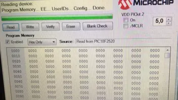

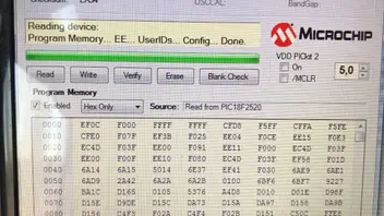

    • #14
    By the way here are screenshots before and after (it‘s only 000, because I have forgotten to deselect protection by default):

    • #15
    The screenshot before giving the error "all protect" is not ok. You should not see this.
    Only "0 0 0 0 ..." is shown - that's not a normal dump...
    The 2nd one looks ok though.

    • #16
    But isn’t 0000 shown due to the protection? As far as I remember it is also explained in the instructions of the Pic Kit software.
    And indeed the protection is activated by default. You have to unclick it in order to avoid it.
    I think I have even read out later once again without protection and saved it, but didn’t took a picture. I have to check my laptop for the hex file.

    • February 23, 2019 at 3:03 PM
    • #17
    Quote from tepee
    If it was really protected, you could not make a dump of the program memory...
    Normally this "all protect" is appearing if the connection is not good. Unpligging and plugging in the programmer into the computer agian normally resolves this.

    • February 23, 2019 at 4:02 PM
    • #18
    It was not protected before, but afterwards when I saved back the data (without Eprom data). The protection was set by default at this step as I wrote, so I set the protection by myself without intention. But I have the original data saved as hex.
