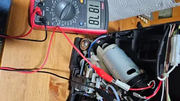

    Hello
    With the motor stopped, this is the value (attached picture)
    And here is a video of me spinning the motor with the multimeter probing it.
