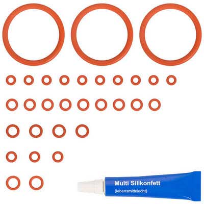

    The DeLonghi ESAM are very reliable. They can last over 20 years and produce over 50.000 coffees with some service and care.
    Every 1 to 3 month:
    Make sure, that the pistion of the removeable brewing unit can be pressed in easily!
    Grease the inner wall of the removeable brewing unit thin with food safe silicon grease.
    After 6.000 Brewings:
    1. Replace the 3 big O-Rings (1 on the upper brewing piston, 2 in the removeable brewing unit).
    DeLonghi Ersatzteile Set XL für DeLonghi Magnifica ESAM mit Anleitung
    DeLonghi Reparaturset mit vielen Dichtungen und Silikonfett zum schmieren der Brüheinheit für alle ESAM Kaffeevollautomaten, inkl. Anleitungen zum runterladen.
    www.juraprofi.de
    plus 12 of this:
    Schlauchdichtung für DeLonghi Kaffeevollautomaten 5313217701
    Dichtungen und O-Ringe für Schlauchverbindungen in DeLonghi Kaffeevollautomaten bequem online kaufen. ✔ PayPal ✔ Schneller Versand
    www.juraprofi.de
    2. Make sure, that the drive spindel is not dirty or running dry. Clean and grease it.
    3. Clean the grinder.
    After 20.000 Brewings:
    1. Replace all O-Rings in the Maschine and the upper brewing piston. Complete maintenance-kits are offert for this.
    2. Make sure, that the black pressure relief hose on the left side of upper brewing piston to the condensation chamber (located between water tank and brewing area in front of the machine) is not blocked. Clean this hose carefully!
    4. refurbish or replace the pump - the piston O-ring is getting hard --> lower pressure and pump performance.

    Thanks a lot for all this information.
    I'm gonna order the O-rings as advised. I think I'll be ok with replacing them.
    The video looks very helpful.
    I'm planning to keep it going for a few more years.
    I'll go ahead with the order and keep you informed.
    Thanks again.
    Lionel
