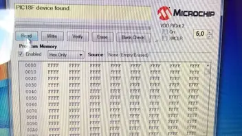

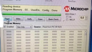

    It was not protected before, but afterwards when I saved back the data (without Eprom data). The protection was set by default at this step as I wrote, so I set the protection by myself without intention. But I have the original data saved as hex.

    But isn’t 0000 shown due to the protection? As far as I remember it is also explained in the instructions of the Pic Kit software.
    And indeed the protection is activated by default. You have to unclick it in order to avoid it.
    I think I have even read out later once again without protection and saved it, but didn’t took a picture. I have to check my laptop for the hex file.

    By the way here are screenshots before and after (it‘s only 000, because I have forgotten to deselect protection by default):

    Roland11: Eprom data was existing before. Then I have erased them and received full FF. But I tested a little and only later I have replaced reed/hall sensor.
