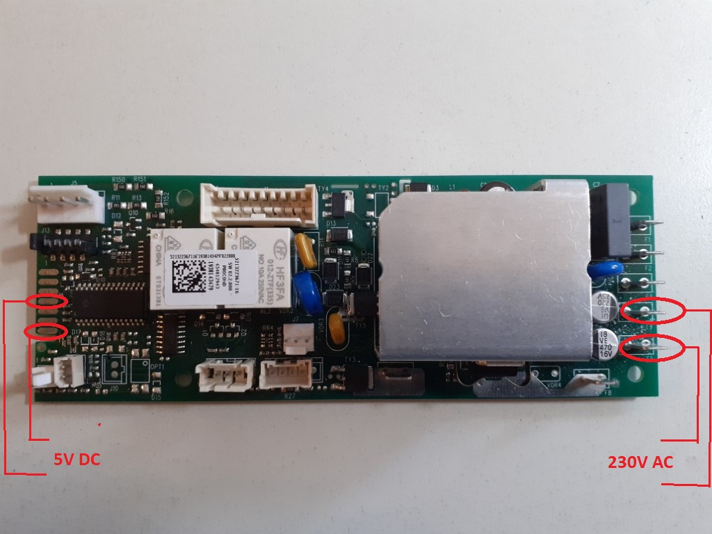

Hello! My coffe machine just stopped working after brewing a cup the infuser was stuck in the up posision, i manually got it down and now im looking at the board, the power components looks fine, there is 5V at the test points, I even tried ordering a new Pcb from the internet but without and success, I checked the contoller board and it seems fine as well, there are no burnt components visible. I tried googling for the answer but mostly get that LNK364GN Most likley is blown, but readings are perfect.
