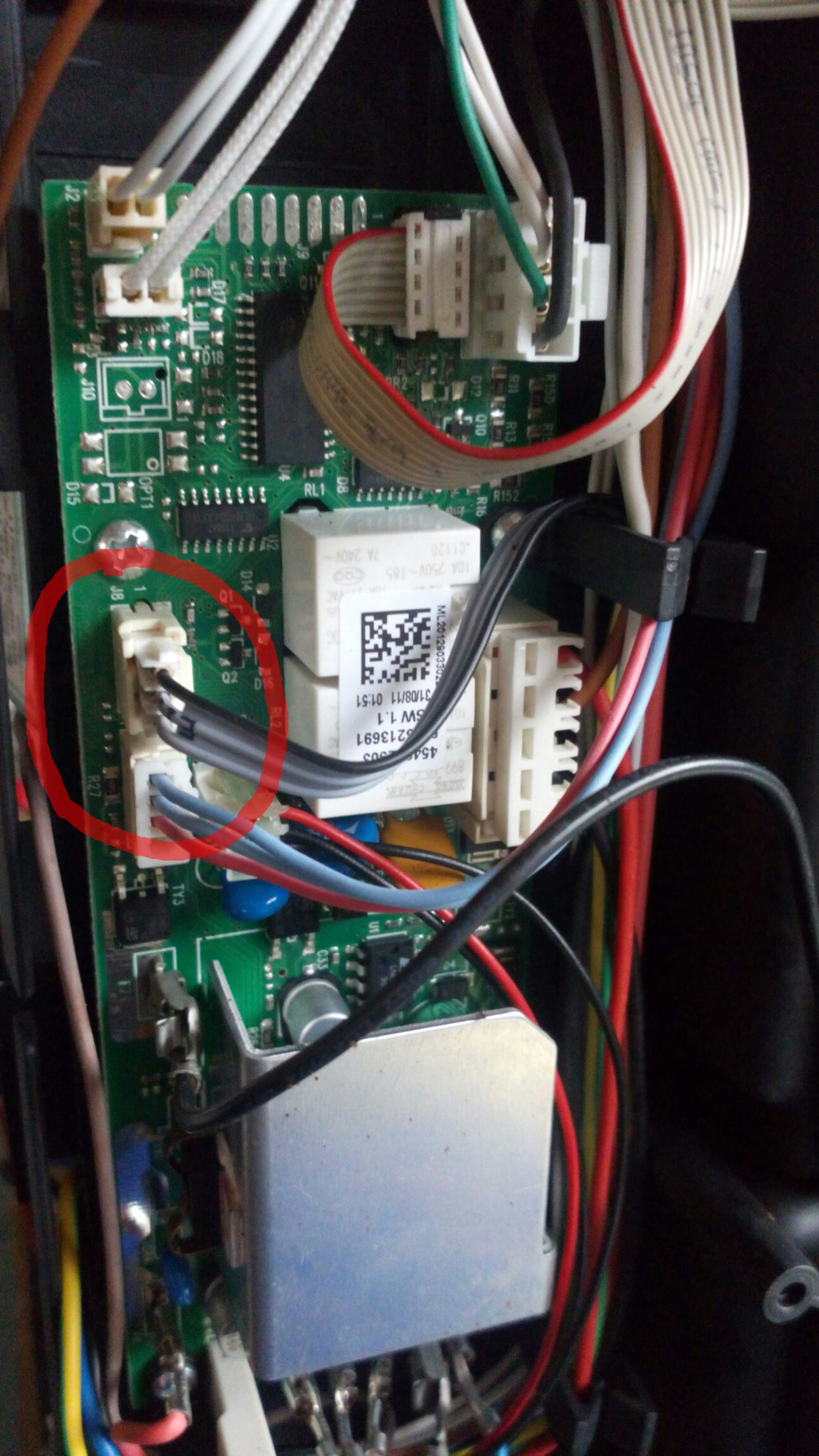

  • I do not understand you. How much Ohm do you have at the points with the blue arrows?
      329,46 kB, 1.504×1.000, 206 mal angesehen
  • cmcshm schrieb:
    my tb other model ​stefan, but 2 termosensors, 1 white its ok 38ohms and other blue 0ohms.
    Show me a photo.
  • Why do you have 2 ohm values. blue and branco are end and beginning of one heating coil!
